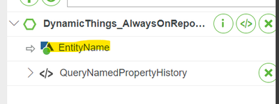

Hi @Velkumar
Which service to pass dropdown widget so that I can get thingname and also which selected Entity should I enter in below so that I can get QueryPropertyHistory service data and bind All data to line chart?
Hi @Pratik_Aswale
In Select Entity you can select your Thing Name
Select Service QueryNamedPropertyHistory service in service category
After that, pass your thing name to EntityName
/VR
