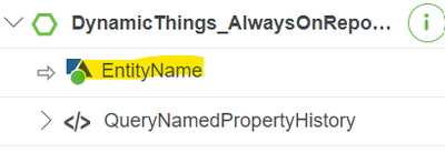

Hi @Pratik_Aswale
In Select Entity you can select your Thing Name
Select Service QueryNamedPropertyHistory service in service category
After that, pass your thing name to EntityName
/VR
