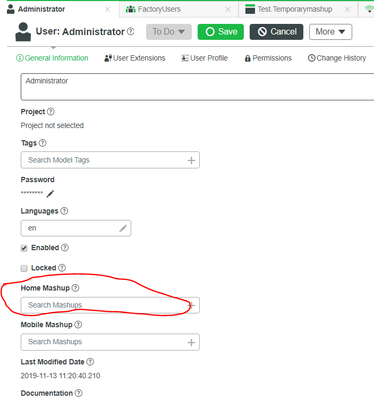

If I understand what you mean by "Project" correctly you create a project and you can link all the relevant things and templates to this. This is however mainly for exporting and importing a project with all the relevant templates etc.
Usually you create one main mashup from which you can navigate to different parts.  Per user you can specify that Thingworx opens on that mashup. This gives the impression similar to when you open manufacturing apps.
Regarding your question on navigation. There are different methods but you can start by using the navigation widget. This is a clickable image to navigate to another mash-up.
