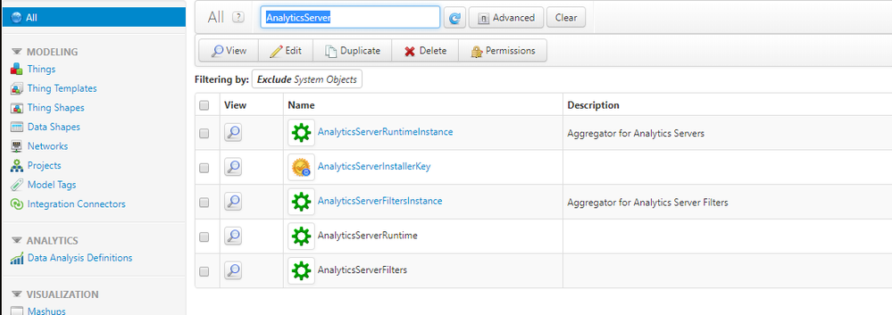

hi
i try to search AnalyticsServer_DataThing in the composer.but i can't find it.
is it there is no that thing in the version 8.2?
Kind regards
Minnan

Hi @MinNan
Could you try to find *DataThing
May be the suffix of this Thing is different. But it should end with DataThing.
