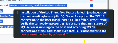

I follow all the steps mentioned in the CWC extended pdf as well the above step mentioned by you. But I am still not getting the extended features in my CWC. What else I can check further?
also when I am trying to install feature manually then I am getting attached error:
jristey
(To:CV0893)
Hello - it appears that maybe your database connection is not configured correctly?  Please open your PTC.FSU.CWC.EXT.MSSQL_TG thing and go to the Configuration section.  Validate that your database is configured correctly.  If your standard CWC is connected and working correctly, it is likely the same configuration that is in the PTCFSU.CoreSQLThing thing.
If your database is connected, the isConnected property should be true (checkbox is checked).  After making configuration changes, save the thing and then run the RestartThing service and check the isConnected property.
Once your database is properly connected, you should be able to manually uninstall / reinstall features as needed.

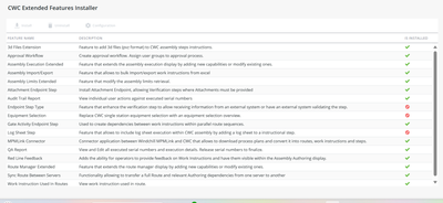

Hi  jristey
I checked the DB connection, and it is connected, I am attaching the screenshot for the reference.
Please suggest me what else I can do in order to get this issue resolved?
In Features mashup, I can see many features as installed but not able to see those on CWC dashboard.
If there is any additional step which I need to follow do let me know. Attaching screenshot for the reference.

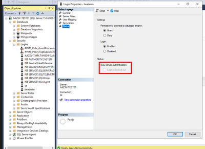

Hi CV
You can get issues like this if the SQL user is locked. I suggest checking this in SQL Studio :
CV0893
6-Contributor
(To:mstarnaud)
login is lockout is unchecked for me, so I believe it is not locked. So, is there any other thing which I can check?
It looks like your message was edited, that the first time it said you had the lock issue and now it says you don't. So I have to ask : did you have the lock issue, fixed it, but now the SQL connection still won't work?
If that's the case, we might need to force the SQL Thing to really try to reconnect. If you go on it in Composer, you could try executing the RestartThing service. Or you could try erasing the password and re-writing it, however doing this too much could risk locking you out again.
