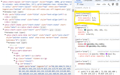

Hi folks,
I have a problem with my 'Line Area Chart' in TWX 9.5.3.
My selected colors of the 'Style Properties' are overwritten by 'fill-opacity: 0.5' from the element ':host([stacked]) [part~=“area”]'.
The “style properties” of the series all have an opacity of 100% so that the colors are fully displayed. However, this has no influence on the pale color displayed.
How can I overwrite this wrong value with 'fill-opacity: 1' with css?
Best regards
Marc

Hello @M4RC ,
Do you happen to have a simple test case you can export as XML and attach to the Community Post?
Have you tried to edit the desired values in the Developer Tools? Did that work?

I contacted PTC support after some time, as the question was asked four months ago. They were able to help me with the following snipped:
@supports (ptcs-style-unit: "PTCS-CHART-CORE-LINE"){
    :host([stacked]) [part~="area"] {
  		fill-opacity: 1 !important;
Best regards
Marc
