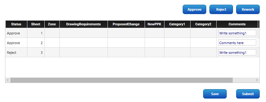

image001 (2).pngI'm trying to change the status field in one row or multiple rows by clicking the button above. For example, if I selected row 3, then I click the "Approve" button, the status field should become "Approve". The field Status in my data shape is  string type, and I plan to write a service to overwrite the status of a row every time I click the button.
I'm trying to do so, but I'm confused about what should I pass in as a parameter for my service, what should I return. Is there any built-in services that can overwrite a field of a data shape inside a data table.

Since you are updating a String with a String I don't see the need for a changing datashape (the data shape defines the base types per column)
You could use the Selected Row of the source to pass that to a service which identifies which row is being updated, update that row at the source and upon Service Invoke complete call the updated data.

Great, I got it to work. Thanks PaiChung

Just a quick question. How can I pass the selected rows to my service? I'm using regurlar grid, I couldn't find that option

All selections are passed in from the Data Source.
So if you look at the right side, the services, it will show the name of the service and have a Data section which has All Data (tied to the Grid) and Selected Row(s)
Dragging that drags a full row, if you needed an individual field value, you'd expand it and drag a field.
