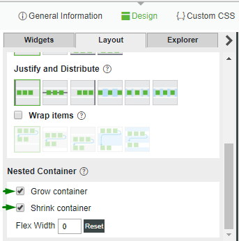

Please try the following steps and see if it helps to resolve the issue:
  • Open the mash up in the design mode.
  • Navigate to the Layout Tab and scroll down to find the Nested Container section.Please ensure that the Grow container and Shrink container are checked. Check the attached image for your reference.ResponsiveAdvanced.png
  • Navigate to the Explorer tab and check if all the containers in the mash up are of type Responsive.
