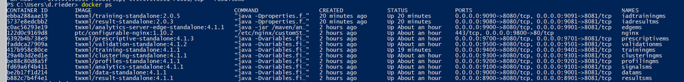

I am asking because in the output of your docker command we see only ThingWorx Analytics components, you should also have a ThingWorx Foundation to work with ThingPredictor.
Since you are accessing Builder you clearly have one, but where is your ThingWorx Foundation installed ? is it also a trial, if yes, same question as above what is its name and where did you get it from .

thank you for replying so fast again! I downloaded the Analytics Trial version from https://developer.thingworx.com/resources/downloads.
The zips name is "Thingworx-Analytics-Trial-Edition-8-2"
My foundation server is indeed a trial version aswell which i installed manually before (Not the Docker installation) with Tomcat. I managed to only install the Analytics Server Component and connect it with my foundation server. My foundation server is running on version 8.2.1 btw.

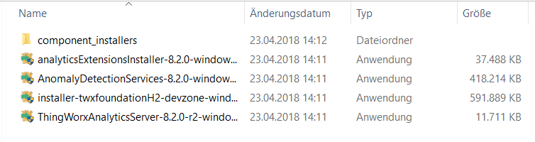

that is strange, i just downloaded the Analytics Trial version again and it has the same components structure.
So when i navigate through the folders
Thingworx-Analytics-Trial-Edition-8-2/ate-windows-installer-8.2.0/AnalyticsTrialEditionInstaller/component_installers
i have this:Screenshot (22).png
And there i choose to install the last application (Analytics Server). Its realy frustrating, i am only trying this approach because the overall installer which would set up a foundation server does not work for me aswell (i have another thread opened for this issue)
Dominik
Edit:
The thingPredictor installer is then again in the component_installers folder, but trying to install it was absolute nonsense because the analyticServer installer already installs the Predictor. I even have a container running with the name predictorms.

I think we have had a mis-understanding.
In the component-installers we have a ThingWorxAnalyticsPrediction-8.2.0-r2-windows-installer.exe.
I am guessing this is the one you are referring to.
I was thinking you had a installer with name ThingPredictor.
ThingPredictor is  available as a standalone component with the 8.2 non trial version, and though it does use the same engine as prediction ms, they are 2 separate things.
With the Trial edition (ATE), it seems both have been merged into one.
However as mentionned in the other thread, I think there is a verison issue with the trial edition downloaded from the dev zone. I don't think that version include the merge.
So you do see it connected in ThingWorx, because the prediction ms is used by Analytics Server for scoring job, but this is different form the agent you need in Analytics Manager as described in https://developer.thingworx.com/resources/guides/operationalize-analytics-model .
As this stage, do not spend more time trying to install the ATE, I am trying to clarify the status about the version on DevZone and the compatibility with ThingPredictor.
I will let you know if the current ATE can work or if a new version is needed (which I think is the case)
