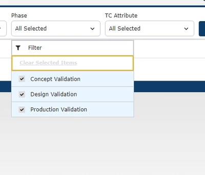

Hi Team,
On mashup load, how to select all values by default from dropdown? and all selected hint text also need to show
Please let me know asap.
Best answer by AS_10340651
You are using a service to populate the entries of the dropdownmenu? then you can use the same service to select all on load - just bind your output of the service to Data an SelectedItems of the Dropdown menu. No need to create a new service if you have already one.
November 27, 2023
Hi @P_10844769
Create a new service or reuse the service which returns all dropdown values and bind it to Widget SelectedValues Property
/VR
December 1, 2023
