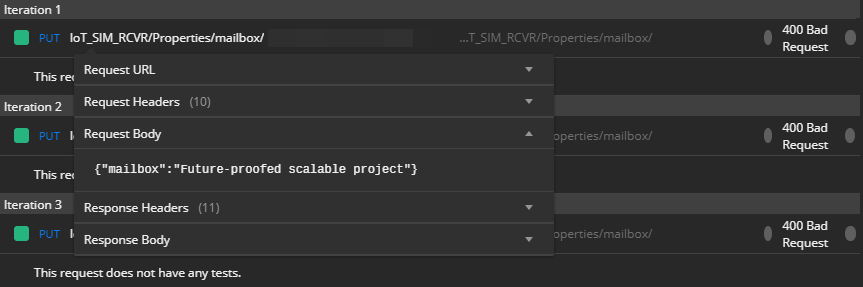

Follow the PTC University course Fundamentals of IoT Development with Whingworx M7.7 Getting Starged with REST. I created another request in POSTMAN which would PUT single value to the Thinwgorx Thing flawlessly.
As I tried to use the Collection Run to PUT a series of values. I got 403 error.
The only thing I changed is the Request Body, but I see no difference in the log.
Both are {"mailbox": "some-string"}

Yes, I'm trying to make multiple updates to the same Property on the same Thing using REST PUT request.
But instead of single PUT Request, with POSTMAN Collection Runner, PUT request would be sent multiple times depends on Iteration and Delay. Each PUT Request contains different Request Body (DATA).
Iteration 1, Iteration 2, Iteration 3... and so on. Like the picture below:

I encountered 2 error. 403 & 400, which were displayed in Collection Runner window.

The only Error message is
| Forbidden content from {{thingworxServer}}/Thingworx/Things/IoT_SIM_RCVR/Properties/mailbox/: multipart/form-data |
Origin c.t.s.c.ContentTypeFilter
Thread http-nio-8080-exec-7
For your request, please try setting Body = Raw
{"mailbox":"{{mailbox}}"}
Please see my screenshot below.
After changing the Request Body(Raw) to
For single PUT request it works fine, where the value of Property\mailbox is changed to {{mailbox}}.

Nevertheless for Collection Runner, even Request Body changes according to the JSON file with each request.
I still get a 403 errors in POSTMAN,
Error log remains the same
Level: Error
Content:
Origin: c.t.s.c.ContentTypeFilter
Thread: http-nio-8080-exec-8
Would it be the ContentTypeFilter issue?

I checked the subsystem configuration, same as yours.
Nevertheless, after accidentally system reboot. POSTMAN Collection Run works out flawlessly.
@tsaifee-2 Thank you very much for helping, really appreciate it.
