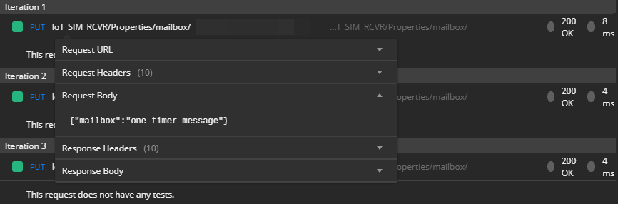

Follow the PTC University course Fundamentals of IoT Development with Whingworx M7.7 Getting Starged with REST. I created another request in POSTMAN which would PUT single value to the Thinwgorx Thing flawlessly.
As I tried to use the Collection Run to PUT a series of values. I got 403 error.
The only thing I changed is the Request Body, but I see no difference in the log.
Both are {"mailbox": "some-string"}

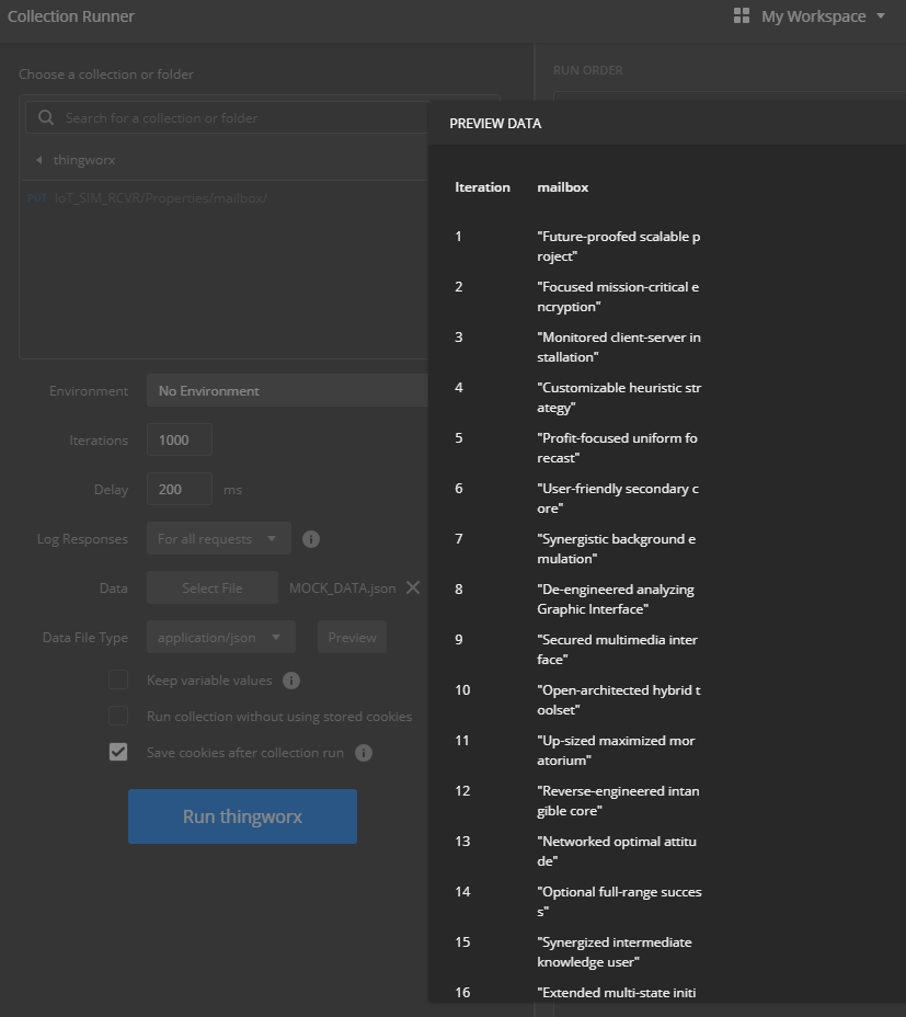

      Hi, @tsaifee-2
      Thank you for reply.
      But I'm looking a way to PUT multiple iterations to single Property, rather than PUT single value to multiple Properties.
      It's that I got a JSON file generated by https://mockaroo.com which contains an array that has many objects in it.
      {"mailbox": "some random string 1"},
      {"mailbox": "some random string 2"},
      My goal is to PUT those values in the JSON file to Thing Property by Collection Run with given Iterations and Delay.

      Yes,  I'm trying to make multiple updates to the same Property on the same Thing using REST PUT request.
      But instead of single PUT Request, with POSTMAN Collection Runner, PUT request would be sent multiple times depends on Iteration and Delay. Each PUT Request contains different Request Body (DATA).
      Iteration 1, Iteration 2, Iteration 3... and so on. Like the picture below:

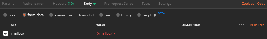

      The only Error message is
      Forbidden content from {{thingworxServer}}/Thingworx/Things/IoT_SIM_RCVR/Properties/mailbox/: multipart/form-data
      Origin c.t.s.c.ContentTypeFilter
      Thread http-nio-8080-exec-7

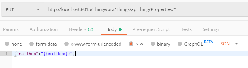

      For your request, please try setting Body = Raw
      {"mailbox":"{{mailbox}}"}
      Please see my screenshot below.
      After changing the Request Body(Raw) to
      For single PUT request it works fine, where the value of Property\mailbox is changed to {{mailbox}}.
