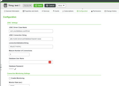

Next you need to crate thing with DataBase or MYSQL Thing Template and you should choose Configuration Tab.
You should provide all information about your DB.
After when you establish connection with your DB you are able to create SQL Query and Commands (Commands are dedicate for Insert, Update,Delete)

here is my Database thing controller configurations which i have. I just put my database sql credentials of myself and changed the database name only
MORE DETAILS:
my SQL  SERVER i have installed locally in my laptop but thingworx is up on server and live NOT locally. I am unable to make a connection with my local database . When i run the service this is the error which i am getting in the thingworx. can you please support me .I just want to connect to my local database. IDK whats a reason may be the port is blocked.

Hi @JK_10565232  SUCCESSFULLY! The database is connected with my thingworx. actually my firewall was making an issue about it and now i am enable it for domain for SQL server. Please ignore my above long query. but it would be great if you would explain the below point which you have written once in my reply.
