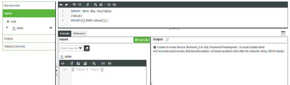

we want to store some data for long term where the dataset maybe become huge and has frequent updates. The community recommends not to use DataTables for this usecase.
So I installed the Relational Database Extension and was quickly able to establish the connection and create the required tables. But now I run in some trouble as the datatable has a lot of columns and we transport the data in infotables around, I would like these infotables or JSONS as Parameters for the SQL-Query/Command.
How can I access these kind of parameters?
This example fails with an exception:
Unable to Invoke Service TestInsert_2 on SQL.ProductionTimeSegment : Execute Update failed: com.microsoft.sqlserver.jdbc.SQLServerException: Unclosed quotation mark after the character string '[JSON.Value]);'.
Additional Question: How can I handle secure dynamic SQL, e.g. create an Table machting a given DataShape?
