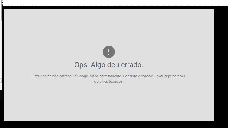

Hi all,
I am having difficult for show the google maps in my mashup.
Happen the following error: "Oops! Something went wrong. This page didn't load Google Maps correctly. See the JavaScript console for technical details."
I even created my API Key and paste in my "Required string to connect with Google for Google widgets" but this did not work.
Leonardo

I followed the guide that you have sent me (https://developer.thingworx.com/en/resources/guides/google-map-widget-how/configure-google-maps-widget-extension) but the problem to be continued.
Below my configuration:
In my mashup the Google Maps get the same wrong:
I saw in other topics that there are configuration in file metadata.xml to do, however this is to older version of ThingWorx Foundation (8.3.4).

Hi @Rick-Stanley
I followed your orientation and I have used the Open Street Map.
Thank you for help me.
