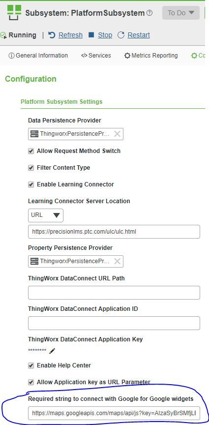

I followed the guide that you have sent me (https://developer.thingworx.com/en/resources/guides/google-map-widget-how/configure-google-maps-widget-extension) but the problem to be continued.
Below my configuration:
In my mashup the Google Maps get the same wrong:
