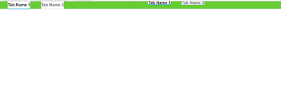

We are using a tab widget in Thingworx 9.2.
It seems we can't reduce "Tab Height" which is available in Thingworx 8.5.
Is there any alternative for this?

Yes, That's okay.
But it seems, only the label size is changing. The Tab header height not changing.

I am trying to adjust the tab header size. It seems it's not meet my requirement.
check out the attached image and entity. (Green background-size needs to be reduced)

I am not sure what changes you may have already have in place, I think this will do what you require.
Add the following to the Custom CSS:
/* Set the band which holds the tabs smaller  */
.widget-ptcstabset::part(tabs-header){
     background-color: lightblue;
    height: 15px;
    min-height: 10px;
/* St the size of the text on the tab to a smaller font */
.widget-ptcstabset::part(tabs-tab-label) {
    font-size: 9px;
/* make the size of the tab on the tab set smaller */
.widget-ptcstabset::part(tabs-tab) {
    height: 15px;
Please let me know if this address your issue.
