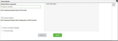

Hello, I'm trying to follow the tutorial "Build a Predictive Analytics Model", I've checked that I do have an AnalyticServer configured and then while trying to upload the data in the Builder section, I do not have any choice to import csv file :

The File Upload extension has not been successfully imported into your ThingWorx Foundation Server. It should have been imported when you imported the ThingWorx-Analytics-<n-n>-Extensions.zip

Thanks for your answer Rick, but obviously the import button is not visible in Chrome but is available while using Internet Explorer.

Maybe https://www.ptc.com/en/support/article/CS286685  can help.

Thank you Christophe, as it doesn't work in Internet Explorer neither (we can fill the name fields in IE, but when hitting submit everything is frozen), so we will follow your advise

We had a very minor improvement : now we can fill the fields for importing the csv and json files but once we hit the submit button, the system is blocked. Here is what we have 1 hour after submitting the request:

I would recommend you open a new thread as the original issue - missing upload buttons - has been resolved.
It would be good if you could mark the relevant answer as correct. This is to help others with the same issues in the future.
For your current issue, once you have opened the new thread, upload also the resulting file from TWALogCollector (https://www.ptc.com/en/support/article/CS316782) , together with your screenshot and someone will look into this.
