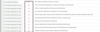

I have installed Thingworx Analytics server along with the extensions  v8.4.5-r1 and I am running into a problem with the Thingworx Foundation service not starting.  All the necessary twx analytic services are up and running, however I do not see any data sets configured in the Analytics Builder once I try to verify connection.Error_Verify_Config.jpgI am at step 5 of the below guide, and not sure how to remedy this.

Hi Ecko665 , Did you create and configure a new dataset. E.g. following this guide https://support.ptc.com/help/thingworx_hc/thingworx_analytics_8/index.html#page/analytics%2Fanalytics-builder-datasets-about.html%23 Best, Asia

I have not configured the new data sets as this was my next step as I see it in the documentation.  Outside of creating the new data set which is simple, I am not sure why the thingworxfoundation service cannot start?  All my other twx services are running, however the foundation service has an issue?
Checking the System Logs, I can see there is an issue with this service.
Not sure how to proceed.

In the first picture you show Analytics Builder with no dataset (which is expected since that is a fresh installation), however this means that you are therefore able to login ThingWorx composer and therefore ThingWrox is started.
Therefore I am confused with the following picture showing ThingWorx-Foundation service not started.
Is it something that happened after you took the first picture of Builder maybe ?
If yes, what happened between the time it worked and the time it did not anymore ?

There is indeed a ThingWorx server that is running and that is the one that got installed with the manufacturignApp.
We can see in the first picture you posted from the Windows services that there is indeed a ThingWorx Server service running (I missed it initially).
What I think happens is that you installed a trial ThingWorx Foundation and then a trial ThingWorx Manufacturing App . However the Manufacturing App comes bundled with ThingWorx already, so the first one was not needed.
So as it stands you should only use the ThingWorx Server service and not the ThingWorx-Foundation, and you should be just fine.
