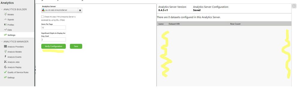

I have installed Thingworx Analytics server along with the extensions  v8.4.5-r1 and I am running into a problem with the Thingworx Foundation service not starting.  All the necessary twx analytic services are up and running, however I do not see any data sets configured in the Analytics Builder once I try to verify connection.Error_Verify_Config.jpgI am at step 5 of the below guide, and not sure how to remedy this.

Hi @Ecko665
I am a little confused by the different information.
In the first picture you show Analytics Builder with no dataset (which is expected since that is a fresh installation), however this means that you are therefore able to login ThingWorx composer and therefore ThingWrox is started.
Therefore I am confused with the following picture showing ThingWorx-Foundation service not started.
Is it something that happened after you took the first picture of Builder maybe ?
If yes, what happened between the time it worked and the time it did not anymore ?

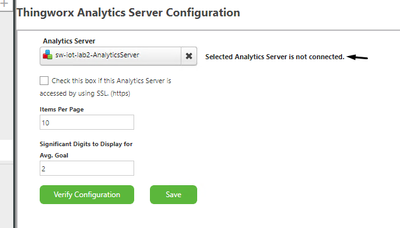

I just checked my analytics server and it says the server is not connected.  Nothing has changed in a week and not sure why this is occurring.  They key is not expired, not sure how to proceed.  The analytics server and adjacent services are all running, restarting my windows server has no affect.

Side note, I did get the analytics server to connect, was just an issue with the key being expired.
