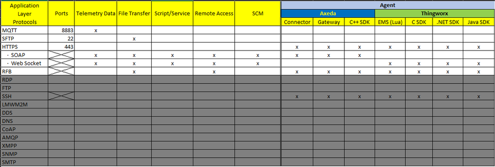

I'm trying to figure out what protocols thingworx agents use for the functionalities below:
Telemetry data, File Transfer, Script/Service, Remote Access, and SCM
My understanding is that EMS and the thingworx SDKs use websocket.  But when I look at the attached EMS documentation, it says it uses REST on pg 4.  I'm confused.  Which protocol is used for the above features?

"The ThingWorx WS EMS provides connectivity to the ThingWorx Platform through the ThingWorx WebSocket-based, binary AlwaysOn™ protocol." : see http://support.ptc.com/help/edge_microserver/r5.4.7/en/#page/edge_microserver%2Fc_wsems_support_matrix.html%23
I believe File Transfer uses whatever protocol is used by the connection between the device and the ThingWorx Remote Thing : http://support.ptc.com/help/thingworx/platform/r9/en/index.html#page/ThingWorx%2FHelp%2FComposer%2FSystem%2FSubsystems%2FFileTransferSubsystem.html
The same seems to be true for Remote Access : see http://support.ptc.com/help/thingworx/platform/r9/en/index.html#page/ThingWorx%2FHelp%2FExtensibility%2FRemoteAccess.html

I realized that the REST calls are made to the platform from outside thingworx if they want to take those actions on the remote thing.
