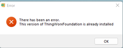

  1. We have installed Thingworx Foundation with "ThingWorxFoundationMSSQL-9.1.9-x64" installer with Windows 10
  2. For some other issues, we had reset the entire windows system. So, every software installed in the system removed including Thingworx and MSSQL.
  3. Now, I'm trying to re-install again Thingworx Foundation with "ThingWorxFoundationMSSQL-9.1.9-x64". But we are getting an error...
    There has been error.
    This version of thingworx foundation already installed​.
If I'm trying to install some other version of Thingworx...
How to resolve this issue and install Thingworx Foundation?
Followed the article.. Following a failed attempt to install ThingWorx 8.5 Foundation/Flow, subsequent attempts result in error "Previous installation of ThingWorx-Foundation is found"
and deleted the Thingworx service using folowing command and installed.
sc delete ThingWorx-Foundation

Hi @Sathishkumar_C
Have you checked the ThingWorx Platform folder? Could be some files have not been removed from there yet
Have you also checked the Database schema ? maybe creating a new schema which different from the first schema of the ThingWorx Model DB ?

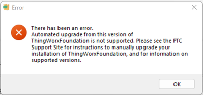

Somehow started the installer...
But in between installation fails... Getting following error. Attached logs also/
Hi @Sathishkumar_C,
You may refer to the following article to see if it helps:
https://www.ptc.com/en/support/article/cs329897

Hi @Sathishkumar_C
Check the user profile folder in Windows for the user that originally ran the install.   Look for a folder called .ptc_ccif.   For example:  C:\Users\Administrator\.ptc_ccif.   Since you're planning to do a fresh install, you can safely remove this folder.
Regards.
--Sharon
It worked for me. As every step mentioned at https://www.ptc.com/en/support/article/CS314780 was done only this step was pending.
Thanks!
