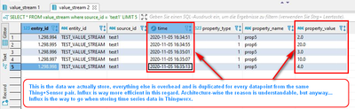

In my case the source is a machine with 140 sensors generating data at 1/60Hz (1 per minute), so ~2.5 datapoints per second.
For your case (100x3/5 = 60 datapoints per second) I don't think PostgreSQL would work well and I'd use Influx.
If you need HA, you'd have to buy Enterprise version, if you don't, you can get away with the free version.
Due to the way Thingworx uses PostgreSQL, there is quite a big overhead in terms or number of rows when storing data (each datapoint for each sensor takes one row so for 100 assets x 3 properties you'd get 100x3 rows every 5 seconds in the Stream table. That would be 300x12x60x24=~5 200 000rows per day.
Storage-wise there is also quite a major overhead. The screenshot below shows a sample row (storing 1 datapoint (value=) for 1 sensor).
I'm not prepared to share exact numbers (that would take some time to double-check everything to make sure), but if I didn't confuse something major, for PostgreSQL one needs like ~40 times more storage space).
