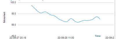

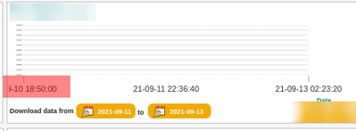

What ever changes I make in the Widget Properties the following issue is repeating again and again, the TimeStamp can't be seen totally on the dashboard, it is only half shown.

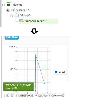

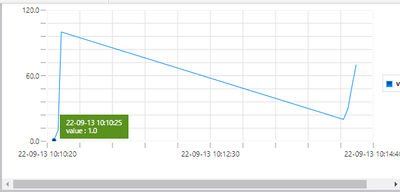

@pshashipreetham I tested Time Series Chart widget with TW9.3.3, but I could reproduce the issue. both timestamp and plot popup displayed fully.
Do you mind sending a demo to us?

@pshashipreetham I put TimeSeriesChart inside FieldSet, still I cannot reproduce. This issue migh reply on some special settings, can you send us a demo so I can check on my side?
