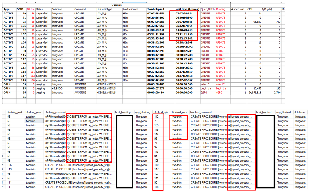

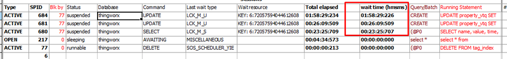

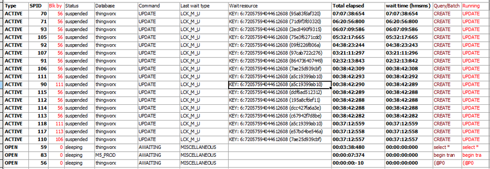

The migration process (7.4.0-b159 to 7.4.19-b262) locked up itself, took 11 hours, then hang up and no progress
I wonder if there is any workaround, or by pass the migration process cause I know this migration does not change the Thingworx database schema.

We tried once again tonight, disabled HA, route all incoming traffics to another server. Unfortunately, it is running for 4+ hours, and deadlock occurred after 2 hours running and locked up until now.
