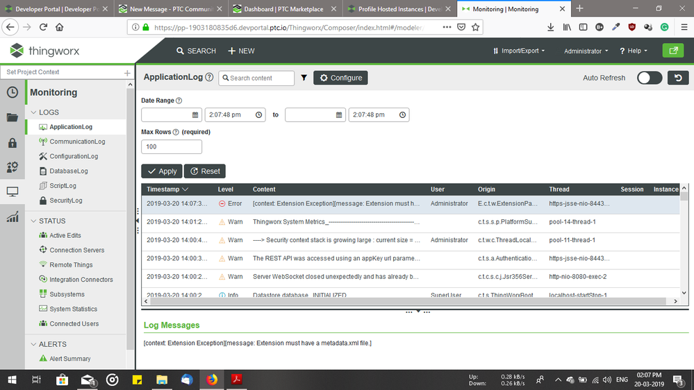

I tried to install Data Export Extension plugin in thingworx 8.4, got from marketplace but cant installed it. it gives error. screenshots as follow.

Are you pointing it to the actual zip file.
since it is saying it can't find the metadata file you can check the zip file make sure metadata.xml is in it.

yes I have pointed it to zip file.
InfinityX
(To:PaiChung)
I found that Zip file should be extracted which contains extension inside it. but tried to install extesion.zip file inside it got these errors.

Looks like the extension needs to be updated for 8.4?
