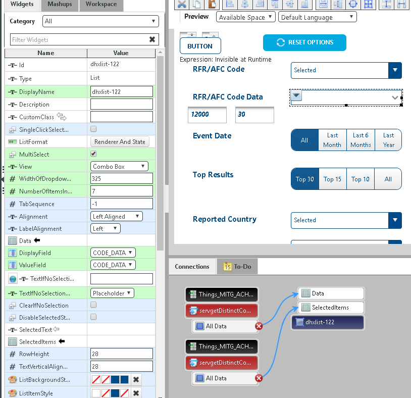

Are you binding the value and display field to a service? This is an example from a similar multi select list. Hope it helps
