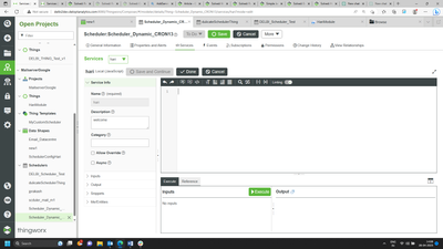

my requirement : this code is used to create particular services in thing.i need to put some text code in that created services How to do this process
var serviceImplementation=me.name;
Things["Scheduler_Dynamic_CRON13"].EnableThing();
Things["Scheduler_Dynamic_CRON13"].RestartThing();
Things["Scheduler_Dynamic_CRON13"].AddServiceDefinition({
name: "hari" /* STRING */,
description: "welcome" /* STRING {"defaultValue":""} */,
definition:"hi welcome",});

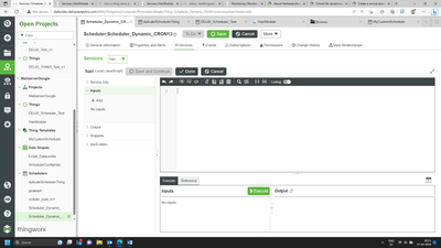

i had added the needed services in the thingscheduler , i need to write the text string in a service through another services please suggest any other way to code

service ->myservice->actionScript is empty how to put some test using service
