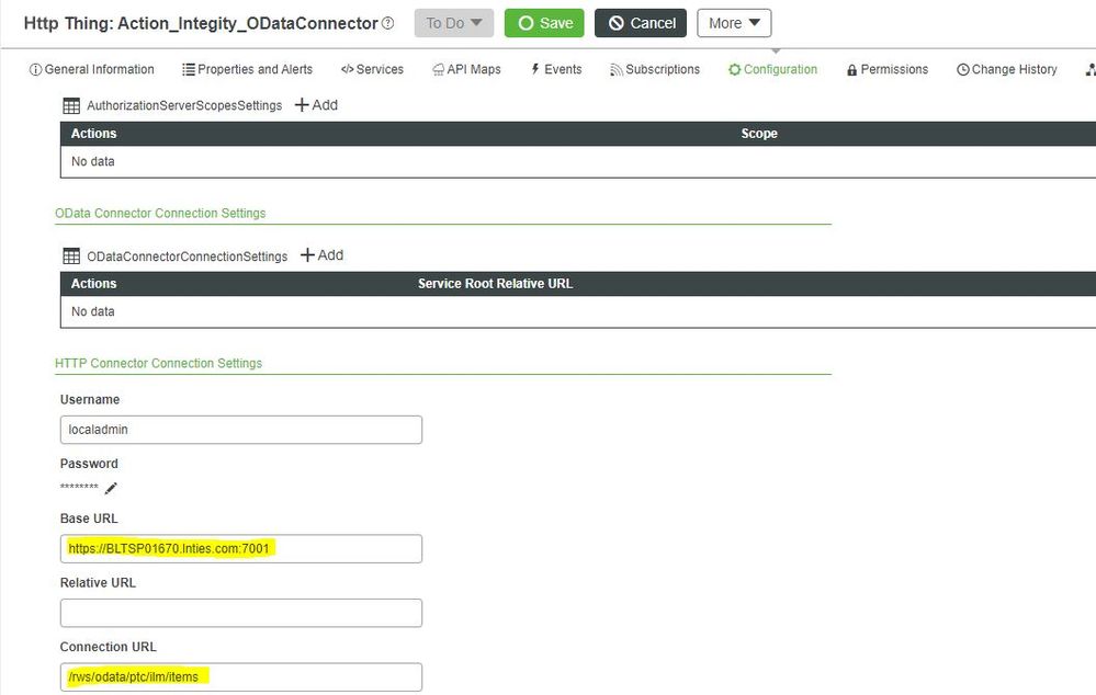

I am using thingworx 8.5 and integrity 12.2.1, which two servers configured with SSL.
through Integration Runtime i am trying to connect integrity

2020-14-01 12:32:12.362 [ClientProcessor-3] ERROR c.t.i.r.IntegrationEngine - Exchange process failed with exception thrown :
Your route exchange has failed. Resource Error [sun.security.validator.ValidatorException: PKIX path building failed:
sun.security.provider.certpath.SunCertPathBuilderException: unable to find valid certification path to requested target]
java.lang.RuntimeException: Your route exchange has failed. Resource Error [sun.security.validator.ValidatorException:
PKIX path building failed: sun.security.provider.certpath.SunCertPathBuilderException: unable to find valid certification path to requested target]

Please follow steps as you need Integrity cert as trusted:
  • Check external server certificate (Integrity) is already in the  TWX keystore by running the following command:
keytool -list -keystore $JAVA_HOME/jre/lib/security/cacerts
  • If certificate is missing add it to Java keystore with the following command:
keytool -import -noprompt -trustcacerts -alias <AliasName> -file   <certificate> -keystore $JAVA_HOME\lib\security\cacerts -storepass <Password>
You can take a look also here: https://stackoverflow.com/questions/21076179/pkix-path-building-failed-and-unable-to-find-valid-certification-path-to-requ
Hope it helps,
Raluca Edu
2 REPLIES 2
Hope it helps,
Raluca Edu
