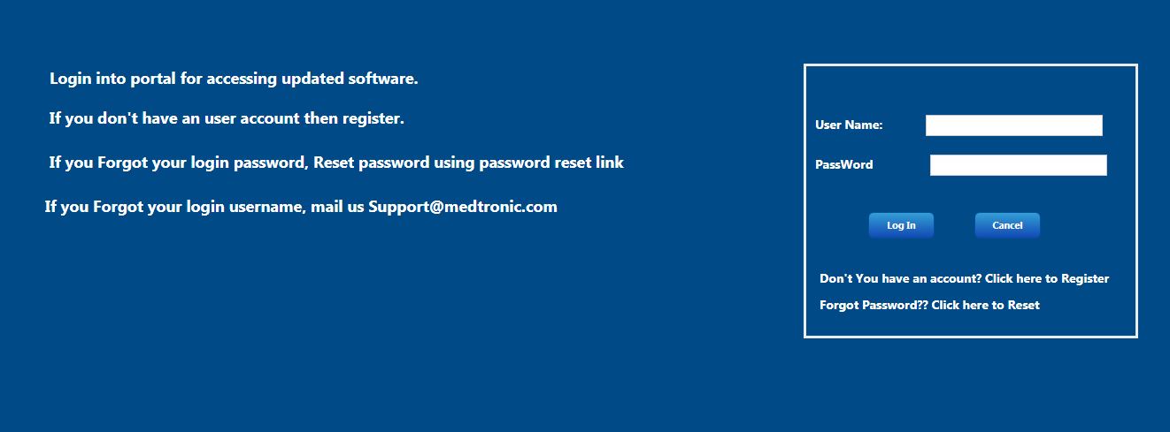

I have custom Login page, It was assigning based on appkey.I need to check user name and password given in that and want to set session for successful credentials. Is it possible.I know the Thingworx form login but need customize my page according to my requirement. my

@supandey sorry my question is not clear, I want user name and password checking service in thingworx, I am implementing my own login exactly like  Thingworx form login.Any ideas to achieve this
