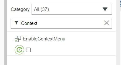

shall we disable the column selection popup which comes while right clicking the advgrid columns.

Disable "EnableContextMenu" in grid property

This property is working fine in grid properties when configuration json is not used.
But in my scenario, configuration json is used. And "enablacontextmenu" property i not available after configuration binding. Now how to disable column menu when configuration json is passed?

Set "enableContextMenu" : false in JSON high-level

Yes this worked. Thanks
