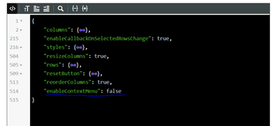

This property is working fine in grid properties when configuration json is not used.
But in my scenario, configuration json is used. And "enablacontextmenu" property i not available after configuration binding. Now how to disable column menu when configuration json is passed?
Hi @AP_10343008
Set "enableContextMenu" : false in JSON high-level
/VR
AP_10343008
(To:Velkumar)
Yes this worked. Thanks
