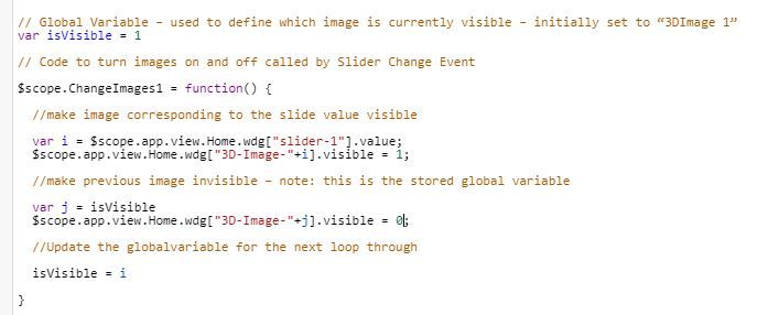

Whilst your solution works it is pretty slow and the image size I think would be prohibitive in making a solution like this work, at least from a satisfactory UX.
Instead I think the original idea of loading the images at the start and making them visible or not visible depending on the slider position seems more attractive.  I have a broad concept of how this might work but I don’t know enough about to Java to get it to implement properly as I need to use a global variable (or something similar to contain a reference of what current image is visible) and I can’t make that work.
My concept is something like this
Might this work if implemented properly?
Sy
sebben
(To:therealSy)
actually this should work... The only problem here is that you have to put all your images manually in the scene.
Can you describe what happens if you try it out? And do you get errors in the console? ( Press F12 in your browser)
That's really weird.  It is now working despite previously nothing happening.  I wonder if there was a glitch somewhere the first time round.  Only issue is that slider has a starting value of zero so that needs offsetting by 1.
Ill accept your first answer as it worked but other than the pain of setting the experience up this seems to give a better UX.
