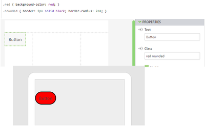

Yes, you can do exactly that, except use a space-delimited class list instead of commas. So the Class parameter should be "GENERAL green" to attach both the GENERAL class and the green class to this object.

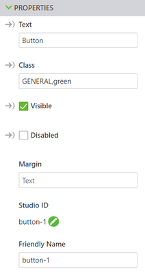

Back to my topic, I know how change class, but our idea is to assign a second class to the same element or create a custom attribute.
EXAMPLE
dozens of buttons, all of them must be black, but some of them must become red if :hover, some green, some blue, etc...
So, in this case, usually you have a base class (GENERAL) and a "color classes" to be combined with the main one.
If in the future I change the style GENERAL, all button change without copy-paste the style for every button red, blue, green, etc...
Like multiclass assignement in the picture (I know it doesen't work like this).
