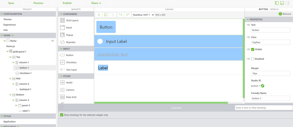

I recently updated my Vuforia Studio to version 9.19.11 from 9.12, but now I'm encountering an issue. When I try to change the height of a grid row or the background color, the changes are not visible on the canvas. They only appear when I load the preview. Is this behavior expected in this version, or could something have gone wrong during the update?
It seems that other widgets are functioning correctly; it's only the grid and panel widgets that are problematic. I've already tried reinstalling, rebooting, and using another browser (Edge).

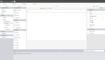

I do not think that this is desired behavior, especially this was working in older version. I checked on simple project and I think I could reproduce the problem as you reported:
I will check with Studio R&D team this issue. Thanks!

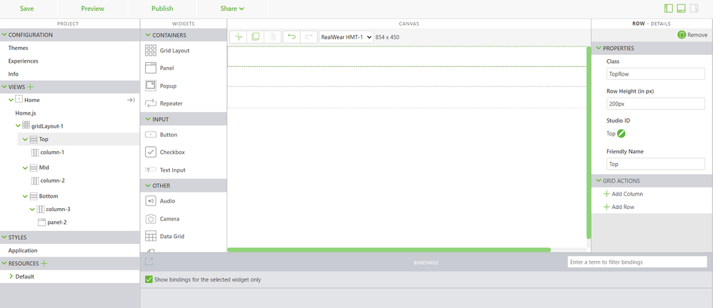

  • Just as you did in your first reply. In my case, I created a 2D eyewear project, added a grid, set the row height to 200px, and a background color, but the changes don't reflect on the canvas, only when loading the preview. Other properties like Alignment and Justification also don't work.
  • This issue occurs consistently; everything else works normally. The time it takes when clicking save or preview is also normal.
    Canvas => Preview:

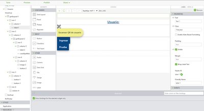

Another project I made looks like this:
