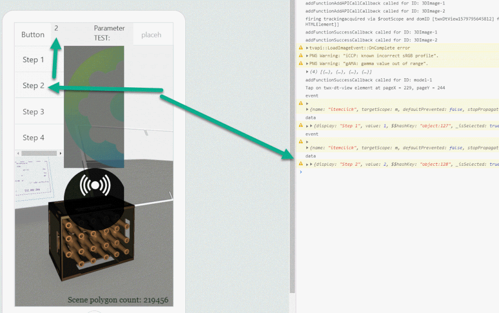

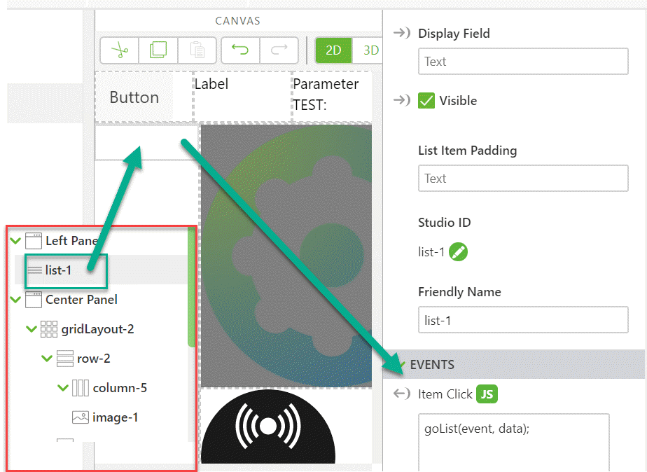

  • Automatic creation of widget. There is not direct functionality to achieve this. You can for example manually add some functionality by editing of <Veiw.json> and <view>.js – e.g. Home.json and Home.js. In the Home.json you can add some widgets and in the Home.js the corresponding code which supports these widgets but this is, so far I know, strongly not supported. It could work but will possibly lead project corruption.
  • I think the better approach is to use instead of single button widgets a ListWidget  or some repeater widget where we will list the steps and provide a click event which will call the correct step. So means we can create some json which contains some kind of structure of the sequences with the steps and we can try to display as list and provide a click listener which will call the correct step.
so we can use some code like this:
$rootScope.$on("modelLoaded", function(){
$scope.populateList();
$scope.goList = function(event, data) {
//set the selected value to the current_step parameter
 $scope.app.params.CURRENT_STEP = data.value;
//this will fill the list widget
$scope.populateList = function() {
var listvalue=[
 display: "Step 1",
 value: 1
 display: "Step 2",
 value: 2
 display: "Step 3",
 value: 3
 display: "Step 4",
 value: 4
 console.log(listvalue);
	$scope.view.wdg['list-1']['list']= listvalue;
 $scope.view.wdg['list-1']['label']= 'display';
The code will define a list as json and will set to the List Property of the list widget
The goList funciton is used then in the Item Click event of the list widget so it will then define the action for a click on list item/on particular step
We can see now the  list which contains the steps and we can click on step to play it.
To play the step we need to create a binding between the parameter CURRENT_STEP and the model widget property Current Step. Additionally we need to call the play service :
 twx.app.fn.triggerWidgetService("model-1", 'play');
