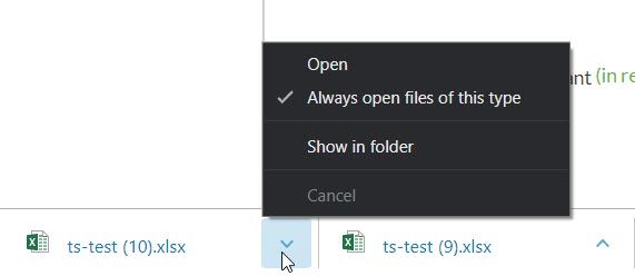

On windows when I clicked the link (file widget)  it did only downloads the file to the download default location. But when I first select the downloaded file and  select the option always open this file:
So, this will open then always the excel file when excel is already installed on the device
