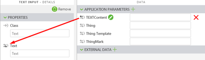

Here is one of the examples to read text from a text file and assign the data to textInput widget.
  • Upload the text file under Project panel -> Resources as shown below:
  • Create an application parameter with any name such as 'TEXTContent' and bind it's value to 'Text' property of the textInput widget as shown below:
  • In Home.js, please write a function similar to below code:
    • $scope.readTextfile = function()
      var httpRequest = new XMLHttpRequest();
      var myFile = httpRequest.open('GET','app/resources/Uploaded/myfile.txt', true)
        $http.get('app/resources/Uploaded/myfile.txt')
             .success(function (data) {
                  $scope.app.params['TEXTContent'] = data;
        .error(function (data, status, headers, config) {
                  //  Do some error handling here
  • Call the above function under the click event of a Button widget

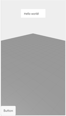

In my text file, I have the contents 'Hello World!'. When I click on the Button the 'Hello world!' is displayed on the textInput widget as shown below:
Hope this helps!
