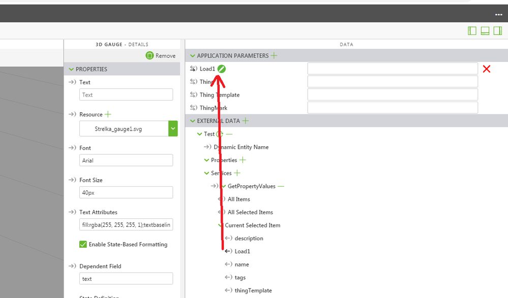

Hello!
Help with this instruction https://community.ptc.com/t5/Vuforia-Studio/Gauge-moving-indicator/m-p/537760
I uploaded two 3D-Gauge: LabelIndicator and Indicator.
I connected to external data: Entities "Eaton-5P-650" services "GetPropertyValues".
Me need to connect the properties "Load1" to the indicator.
What needs to be changed to the code?

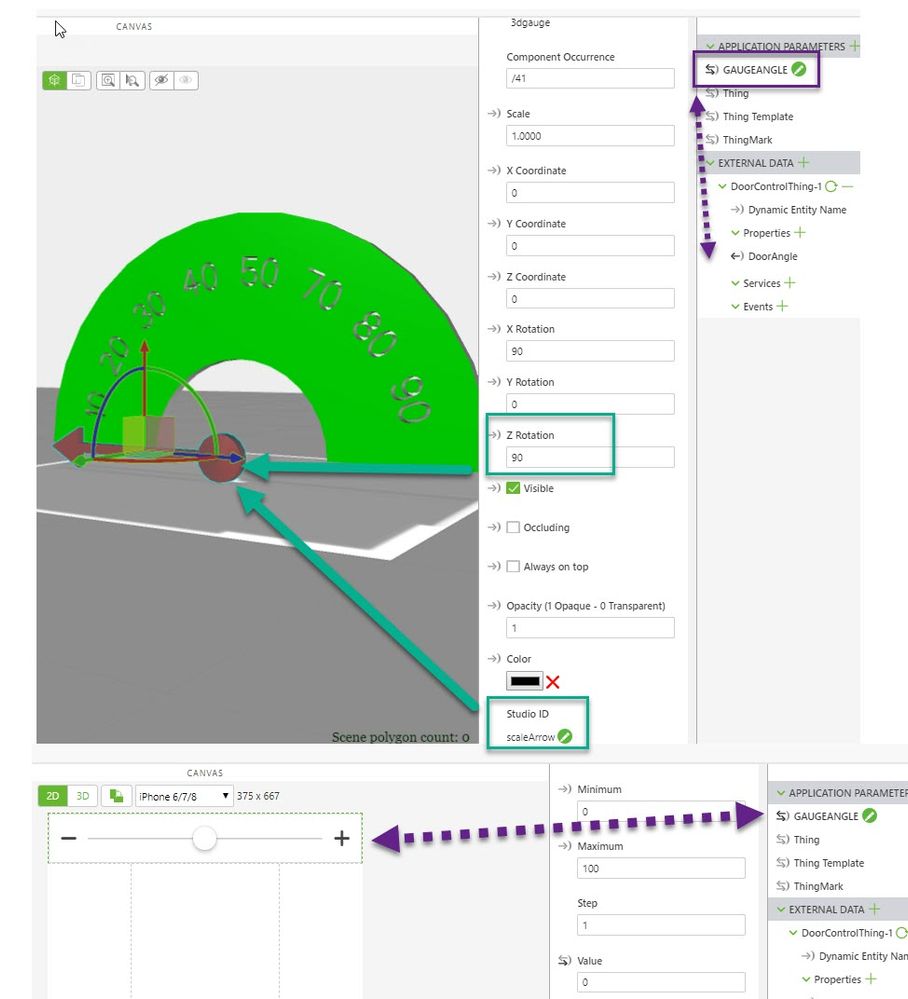

Hi @ifadeev ,
here I attached a small project (attached)  which used similar approach to the mention "Gauge moving indicator" but instead of 3d gauge I used a simple 3d assembly where the arrow is a component used for modelItem  definition:
Here I used a 2d slider widget to set the app parameter for testing. But I also attached here (it is relevant to my environment only) to a Thing property "DoorAngle" and it worked fine.
I used the following javascript:
$scope.setArrowValue = function(val) {
let scaleMin=0
let scaleMax=100
let value=val
if(val < scaleMin) value=scaleMin
if(val >scaleMax) value= scaleMax
 //for angleMin angle in assembly is 90
 //for angleMax angele in assembly is -90
  let deltaAngle= 180.0*value/(scaleMax-scaleMin)
  let angleCalc= 90-deltaAngle
 $timeout(function () {
 $scope.$applyAsync(()=>{
// for print in the console need to comment it
   console.log("called $scope.setWidgetProp rz with angleCalc="+angleCalc);
    $scope.setWidgetProp('scaleArrow', 'rz', parseInt(angleCalc));
},5);
$scope.$watch("app.params['GAUGEANGLE']", function() {
$scope.setArrowValue( parseInt($scope.app.params['GAUGEANGLE']))
Then I tested it in the preview:
I attached the project to this post and hope it could be helpful in your case.

ifadeev
(To:sdidier)
If I change to
$scope.$watch("app.params['Load1']", function() {
var rotation = $scope.app.params['Load1']; //instead of "value", fill in the name of the parameter you want to bind to the indicator
that doesn't work.

ifadeev
(To:ifadeev)
Eee! It;s worked!
I,m add application parameters and drag and drop there external data properties.
Hi @ifadeev ,
I used the following javascript&colon;
let scaleMin=0
let scaleMax=100
let value=val
},5);
