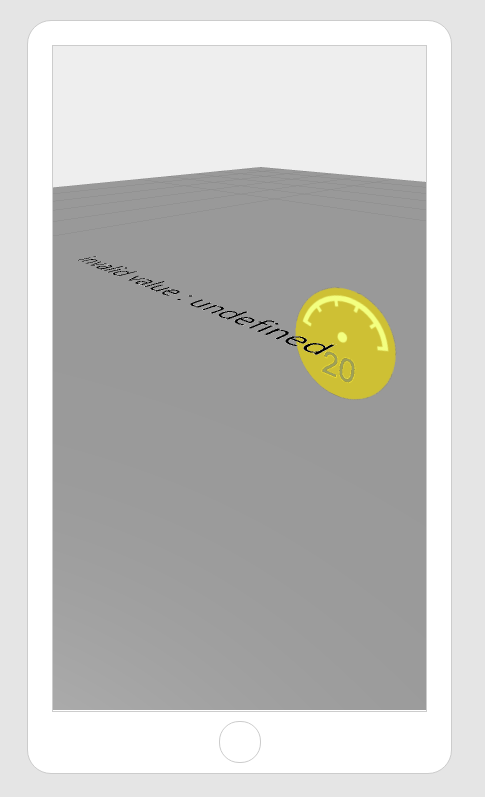

Hello!
Help with this instruction https://community.ptc.com/t5/Vuforia-Studio/Gauge-moving-indicator/m-p/537760
I uploaded two 3D-Gauge: LabelIndicator and Indicator.
I connected to external data: Entities "Eaton-5P-650" services "GetPropertyValues".
Me need to connect the properties "Load1" to the indicator.
What needs to be changed to the code?

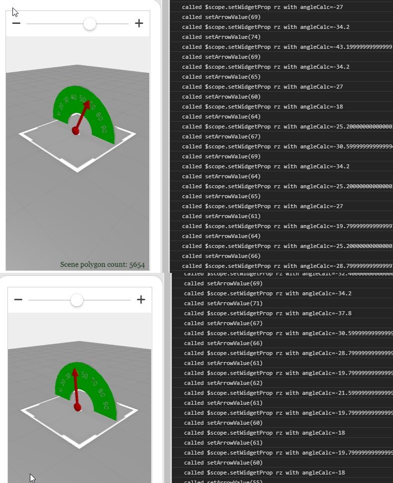

Hi @ifadeev ,
here I attached a small project (attached)  which used similar approach to the mention "Gauge moving indicator" but instead of 3d gauge I used a simple 3d assembly where the arrow is a component used for modelItem  definition:
Here I used a 2d slider widget to set the app parameter for testing. But I also attached here (it is relevant to my environment only) to a Thing property "DoorAngle" and it worked fine.
I used the following javascript:
$scope.setArrowValue = function(val) {
let scaleMin=0
let scaleMax=100
let value=val
if(val < scaleMin) value=scaleMin
if(val >scaleMax) value= scaleMax
 //for angleMin angle in assembly is 90
 //for angleMax angele in assembly is -90
  let deltaAngle= 180.0*value/(scaleMax-scaleMin)
  let angleCalc= 90-deltaAngle
 $timeout(function () {
 $scope.$applyAsync(()=>{
// for print in the console need to comment it
   console.log("called $scope.setWidgetProp rz with angleCalc="+angleCalc);
    $scope.setWidgetProp('scaleArrow', 'rz', parseInt(angleCalc));
},5);
$scope.$watch("app.params['GAUGEANGLE']", function() {
$scope.setArrowValue( parseInt($scope.app.params['GAUGEANGLE']))
Then I tested it in the preview:
I attached the project to this post and hope it could be helpful in your case.

Hello Ifadeev,
As I have understood the original thread and post, it is needed to bind the Property Load1 to the Application Parameter named value.
If you have an Application Parameter with another name, in Javascript source code, it is needed to change these lines in the original Javascript function  :
$scope.$watch("app.params['value']", function() {
var rotation = $scope.app.params['value']; //instead of "value", fill in the name of the parameter you want to bind to the indicator
Change value to the Application Parameter name.

If I change to
$scope.$watch("app.params['Load1']", function() {
var rotation = $scope.app.params['Load1']; //instead of "value", fill in the name of the parameter you want to bind to the indicator
that doesn't work.

ifadeev
(To:ifadeev)
What is now
LabelIndicator -Invalid value
Indicator - not view

ifadeev
(To:ifadeev)
Eee! It;s worked!
I,m add application parameters and drag and drop there external data properties.
