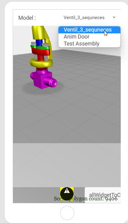

How to create an entity with data for a Dropdown list? I have a limited version of ThingWorx. I can't find any fully described instructions on how/or where to create the data for the dropdown widget in Vuforia Studio. There are some instructions about creating the whole widget in Thingworx but I use Vuforia Studio Dropdown widget. Please share the instructions for Vuforia Studio.

if you want to fill the widget list /e.g. select widget with data? In this case you need to create a Json list/object containing a value and display and value:
$scope.populateModelList = function() {
 $scope.my_json=[
    display: "Ventil_3_sequneces",
    value: "app/resources/Uploaded/Ventil_3_sequneces_publish.pvz"
    display: "Anim Door",
    value: "app/resources/Uploaded/anim_door2.pvz",
    display: "Test Assembly",
    value: "app/resources/Uploaded/test_asm.pvz"
$scope.view.wdg['select-1']['list'] =$scope.my_json;
$scope.$on('$ionicView.afterEnter', function() {
$scope.populateModelList(); }
Here the list for 3 datasets and then set the value to the select-widet. Where the value is directly bind to an resource of Model (src).
demo project attached
Or is the goal in your question something different?

@RolandRaytchev Appreciate quick response 🙂
