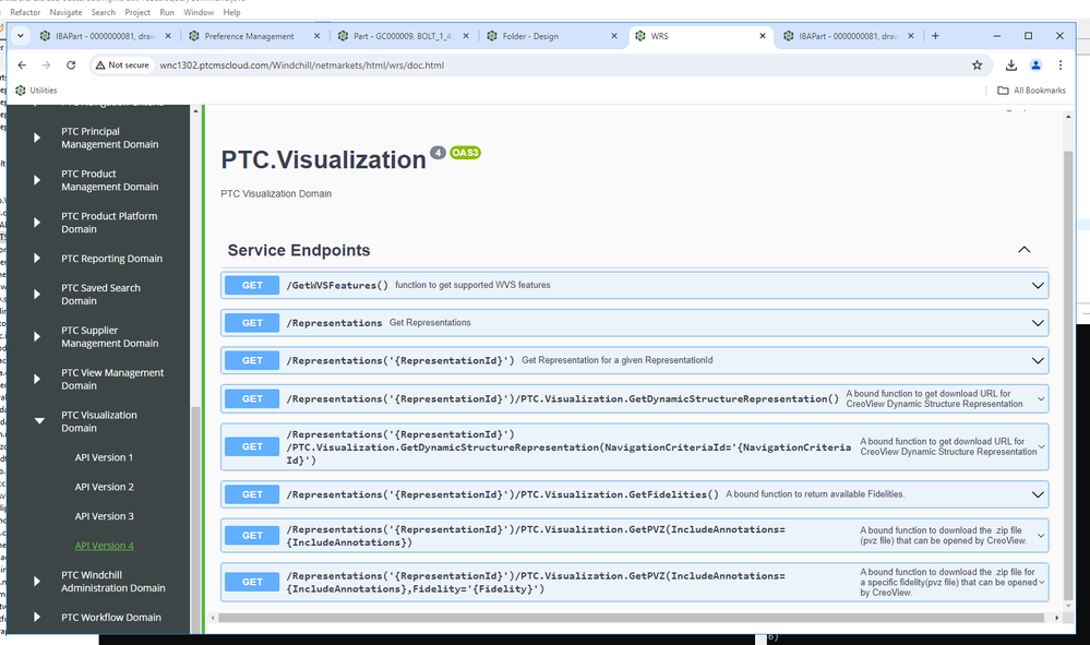

Hey Community,
Is there any possible way to integrate Windchill and Vuforia studio. My use case here is, I need to list out all the available 3D model available in Windchill into Vuforia Studio screen, based on user selection I need to show 3D model in 3D Model widget. This question has already been asked in forum but i still could not find a right answer and definetly need more insights into this topic. Please give your valuable feedback.

you can download data possibly directly from windchill or other server but that will not work because of CORS. So means that Vuforia View will not allow a call via different domains. so therefore the supported way is to use Windchill data --> to Thingworx repository --> Vuforia Studio
Here I want to refer to point 1.) of that post : https://community.ptc.com/t5/Vuforia-Studio/Is-there-a-way-to-load-3D-model-from-Thingworx-repository-to/td-p/961474
for the Integration  from  windchill to TWX - so the step is to export first from Windchill the  pvz files as export to folder  - as the part what is visualization /Windchill adapter could be seen in the article   https://www.ptc.com/en/support/article/CS112832
  1. In Windchill, if GDD is enabled, export pvz file generated by Creo View Adapters.

 I mentioned in the previous post the usage of customization to the addpater post-publishing process - therefore I  splitted it here into a separte post because it is other technique- possibly more easy to handle.. For that techniques you need that widndchill use visualization  where the cad model are visualized ito pvz internally - so in this case you could extract the pvz file via Visualization Rest API e.g. PTC.visualization.getPVZ()
Here is also an article
[Knowledge Hub] Windchill Visualization Services - Rest Services
which point to a hub - e.g. https://www.ptc.com/en/support/article/CS350641
with following points:
  • How to get the Representation ID in WRS?
  • How to download Representation as Zip (pvz file )?
