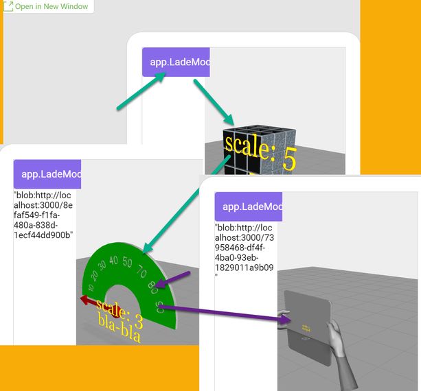

code is not really a good programming style example ... but tested in the 9.21 with project and it worked - tested now in preview - is ok. So far I see your issue is in preview - so frist there to check. I will attach a demo project
To get the project working without many changes you need to have a repostitory thing with the name
const TWXmodelID = 'CADRepository1_test'
or you have to change the code line 6 on Home.js to the name of the repository what you use
Also you have to load some files into a folder of your repository . Add that information in the Lines 37-45
 $scope.app.ListeMods=[
      {'name':'3dgauge1','pvz':'/pvz/3dgauge1.pvz','scale':3},
      {'name':'bla-bla','pvz':'/pvz/bla-bla.pvz','scale':3},
      {'name':'engine_test_exp','pvz':'/pvz/engine_test_exp.pvz','scale':0.5},
      {'name':'mill5MT_High','pvz':'/pvz/mill5MT_High.pvz','scale':1},
      {'name':'navipad','pvz':'/pvz/navipad.pvz','scale':2},
      {'name':'ventil_bg_anno','pvz':'/pvz/ventil_bg_anno.pvz','scale':3},
      {'name':'wandregal','pvz':'/pvz/wandregal.pvz','scale':0.5}
here you should provide information abouth the name, pvz filename and Studio display scale... so means you can change that informaiton according to the used repository folder and data what is loaded there.
Also you need to add LoadBinary into the external data section / so first remove the old objects and recreate the bindings again
Also,please,  take care that LoadBinary service has the correct permission in TWX  but I think that is something what you alreay set ... so regarding  the status of the provided pictures
I hope that helps! If not then, please , let me know. Thanks
