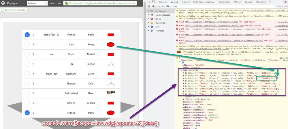

I'm using repeater widget in my project.
listupdate app parameter is binded to data property of repeater widget.
when we click Button, the result is like below.
at this point,
I want to get third column img src value of third row.
how can I get third column img src value?
I attached the project file. please refer to the project file.
and please let me know how get the value.

I think here is not quite clear what is the goal at the end - so means to get the third column  and third row this is  Ok. But what is not clear -when you want to get this in which contex?. This is important question because there could be different approaches . So, you can get data and could count the number column and number row simple form to repeat data property:
So you can retrieve simple the data
let my_data =$scope.view.wdg['repeater-2']['data']
console.log(my_data[2].src)
//this will print here "test2.svg"
 and here (example ) the print of 3 row 6 column is "test2.svg"

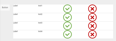

But I think possibly your goal is to click on element and to try  to find the value , respectively to change the value in cell . So possibly the following behavior as shown on the picture below:
So in this case you can use the callback for the clickItemInRepeater event:
twx.app.fn.clickItemInRepeater = function(item,list,isMultiSelect){
//... your definition
there in the call the list contains the list - means that what is the data in the repeat widget
I hope this will make it more clear- and the item is the clicked row.
Also you can find the demo project (I mentioned int he picture above) in the post https://community.ptc.com/t5/Vuforia-Studio/list-widget-js-api/m-p/803441

One hint I can give you is this. If you want to inspect your elements you can do this:
Open preview -> Click on "open in new window" -> Open console (e.g. F12) -> Type in "window.twx"
Now you can navigate to your widgets : appScope > view > home > wdg > repeater-2
The image source of the third row will be the same as the original one, since it is only repeated.
