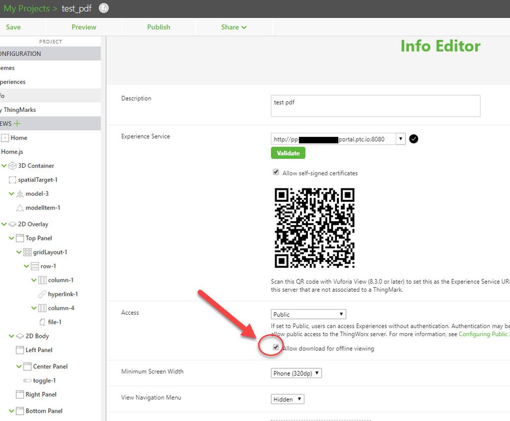

Hi @ForrestA ,
I am wondering a little about your comment - that the demo project will cause a problem in offline mode
In the demo project I attached to my previous post all URL's are local referring to the resources/Uploaded folder. This means that the project is loaded only one time. In generally every project should have a problem in airplane mode if it should be loaded from Experience Service. For this your need internet access to the server.
But if you setup your project as enabled offline mode, in this case when you load the project one time to the device this should generally work also in offline /airplane mode.
I tested the project test_pdf from previous post  - where I downloaded it to the device / this time I tested on Android Galaxy S9+ with activated airplane mode. It was working fine , no difference to normal connection because here all links are pointing to the local upload folder that these file are downloaded for offline work when the complete project was downloaded.
In this case I started the project from View , project-> download tab
