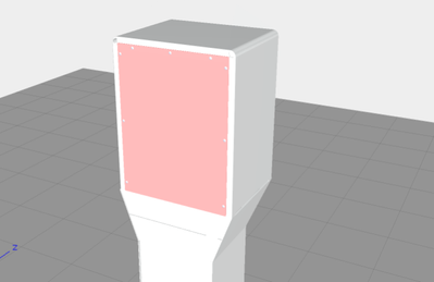

Hello All,
When I change a model-item color, the new color cannot fully replace the color set in the 3D model.
Here for example the the sheet metal cover was red in the 3D model and now that I've changed the model-item color to white, the red color still is lightly visible.
I can change the color using the tml text widget and a shader, but I am not experience enough to add a shadow in the shader.
So my question has two parts:
- Can someone share a shader code for color changes that also includes a shadow?
- Can I change the color completely in the experience without using a shader?
Here is the color change shader code that I am using:

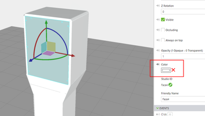

Hi @AlexK ,
I do not think that using shader is the best approach when you want to set only the  color.I think it is possible to use a shader  but at least seems to be overdone. But possibly I need to understand better your problem here
You mentioned model Item widget  and model color. So I think here possibly  we need to consider what is the goal and how the problem occurs.
When we have a model widget where the source is pvz file - mostly it is an assembly. You can define to each component of this assembly a model Item widget. So, each model item widget has a component path which will specify explicitly the assembly component  where the model Item widget will apply the widget properties . In this case the color for the component will be applied only for the component specified by the component paths parameter. So first we need to check the Component Occurrence property of the model Item widget and change the path to apply the widget setting to different component. Possibly this could help in your case.If this will not help for any reasons  , we can check more advanced features like javaScript code or shaders
