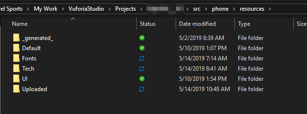

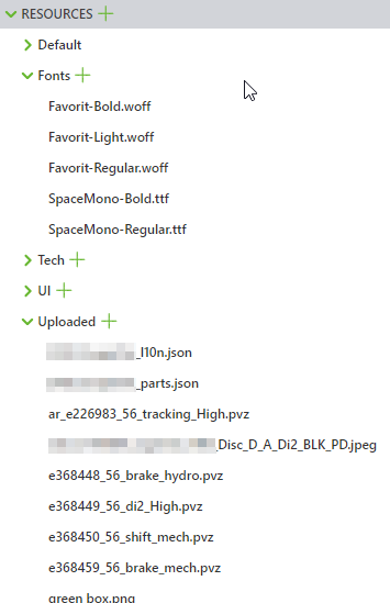

@Wes_Tomer you can already add folders as needed to Resources. You need to create the folder outside of the Studio interface but then you can view, add & remove content from them in the Studio interface. Here are some images that should explain this.
Wes_Tomer
(To:jmikesell)
Organization through the computer file browser - very nice tip. Thank you for this!
I first tried to create a folder within the Uploaded folder, and this did not work -- So I created a folder at the same level as Uploaded and Default and this did work.
