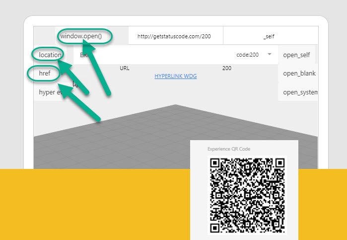

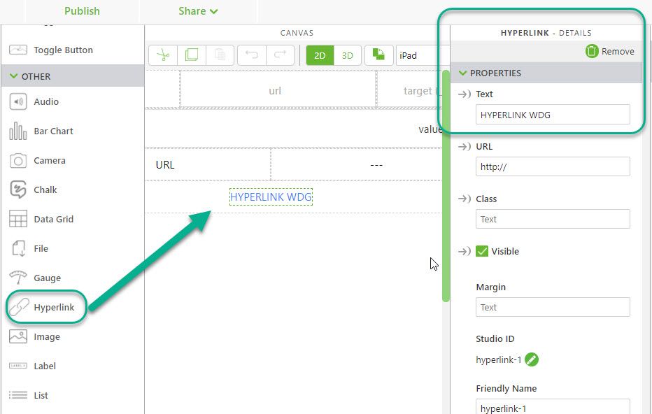

Hi @leonardosella ,
you can try to add in your project a hyperlink widget. So far I remember (tested on IOS in the past)  this will change the behavior also when you try to open the web link  via the setting of
window.location.href
 (so in this case the hyperlink widget could stay invisible)
I don't understand. Could give me an example?
what I meant was to add a hyperlink widget to your Vuforia Studio project - no further action  else:
So far I remember addting of this widget to the proejct will change the behavior in Vuforia View  on end device (at least I observed such behavior some time ago and therefore mention if it could be helpful in your case - but your need to test it)
I found one project  where I tested similar functionality. /attached here
Ok, hyperlink is exactely what I'm searching.

But back to the project I attached in my pervious post. When you start it and click on the one of the marked buttons below it was working when I tested it now on  Android and on IOS.
It called successful  the sample link reference in the external browser of the device. Did you check it?

ok, understand, but could you please, test the project  I attached , justs to see  effect when you click the  metioned / marked buttons. You can scan the project simple from the QR code
