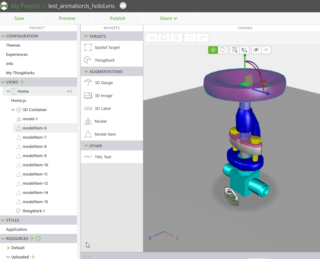

Regarding to the question about hidding of 3D modelItems in the sequnece. So for example this code will work on hololense :
setTimeout( function () {
var a1=var_arg1; //arguments to inline function
$scope.$apply(function () {$scope.view.wdg[a1]['forceHidden'] = true;});
$scope.$apply(function () {$scope.view.wdg[a1]['visible'] = false;});
$scope.$apply(function () {$scope.view.wdg[a1]['forceHidden'] = false;});
clearInterval(timerId);
console.warn("started the timeoutfunction for "+ a1);
} , 3000);
I tested it and could verify that the 3D ModelItems are hidden after the 3 seconds.
-another approach will be to use the transparency (opacity property set it e.g. to 0 or in loop form 1-0 to have some effect like fade out)
So, regarding to your solution I have some points what I want to share.
For example we can have the case that you deleted and created modelitems so that they will be not continues in this case , may be, in this case you need something where you can use a list and specify there how to move your modelitems via different sets of speed , direction .etc.:
Here an example of code (I tested it on hololens and it worked fine) and should demonstrate how such solution could look like:
