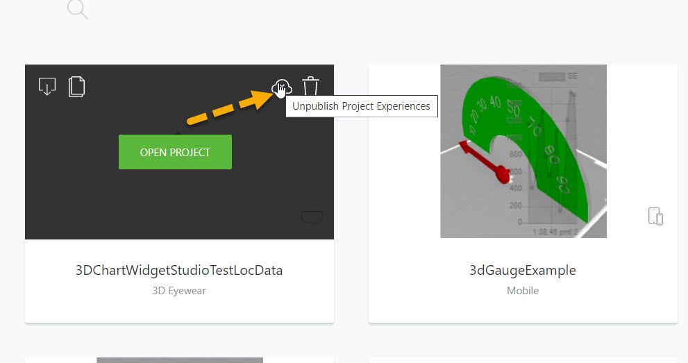

To delete a project form the server : when the project is in your Studio environment -you can :
simple click the unpublish symbol for the project.
When the project is not in your system but you know the URL of Experience Service and the name of the project and also you have a login with admin /or developer permissions - you can use the curl->Delete an existing project (replace "myproject" with the name of the project to be deleted):
curl -u user:password -H "Content-Type: Application/JSON" -H "X-Requested-With: XMLHttpRequest" -X "DELETE" https://localhost:2019/ExperienceService/content/projects/myproject/
